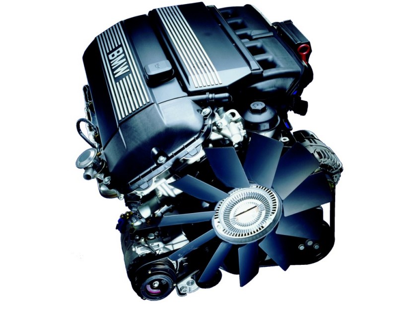

Ето това е маторя,само че с друго окомплектоване
M54
Straight 6 DOHC 24V with Dual VANOS. 2000-present. 126kg 277lbs
Used in late model Z3, all E39 and E46 six cylinder models
2.0 (150bhp), 2.2 (170bhp), 2.5 (184-192bhp), 2.8 (193bhp), 3.0 (231bhp)
От тази тема http://bmwpower-bg.net/forums/viewtopic ... ght=engine
